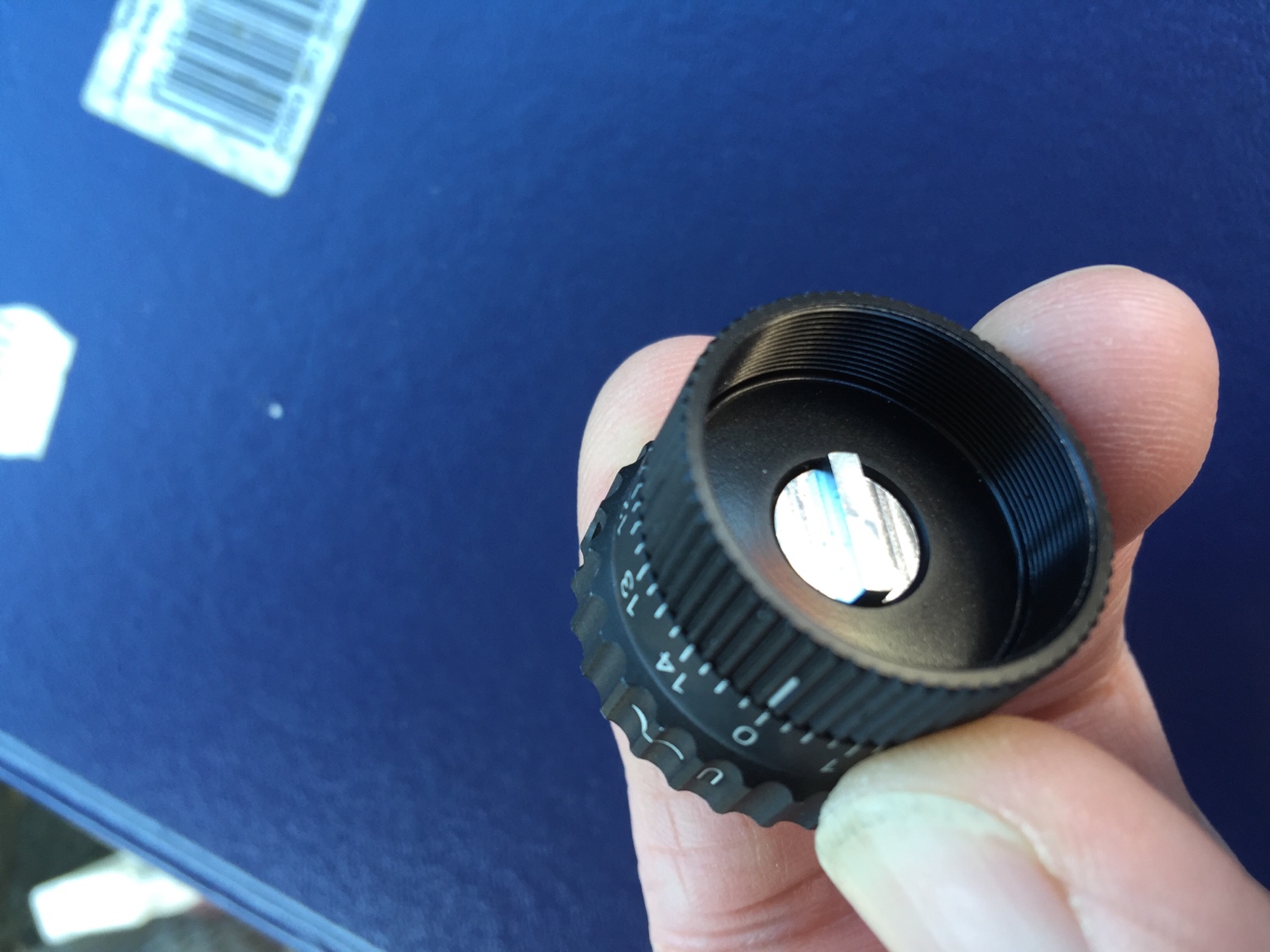

The s1 elevation dial I got from a couple years back, I think I got it for 65 bucks? I hope my data isnt dated at this point. I had to call in and do it over the phone, no web support for it.
They come without a zero stop by default but you can request the zero stop version. I didnt know that but I called in after the fact (and these pics) and they sent me zero stop version.
The zero stop version limits it to one revolution but you can get more by not tightening it all the way low on the turret, lift it up a tad and then tighten the locking screws and you can make it act as more of a detent and slip over the top with a bit more rotational pressure, sort of like a mtc turret.
It should work on all the scopes vx2 and newer. You just pop off the little black cap for finger adjustability that comes on the turrets from the factory and you expose the screw slot adjustment underneath.
The vx2 above will work, the vxll below will not. You just pry the little black topper off.
The whole turret assembled.
The turret in its pieces. A base, zerostop ring and cap.
The zero stop ring installed on the base.
This is the non zero stop version of the top cap, the zero stop version has a little ball bearing that goes in the divot, that ball bearing is what interacts with the zero stop ring. By raising it up just a tad before locking it down like I mentioned before the ball bearing will hit the stop letting you know you are back to zero but can still slide over the stop for access to a second revolution. Just have to remember that you skipped over it when you dial it back down.
And installed on my vx3

The very informative pics that spife7980 posted appear to be Leupold's S.O.D. (screw on dial). Does the bottom of the dial have a tab that sticks into the slot on the base dial?

Yes, stole this pic from the web
Leupold suggests using a bottle opener to pry off the "plastic piece that has the click markings on it" - was this easy? I assume since your package contains a "stop collar" this is for elevation only. I would guess the package without a zero stop might work for windage.

Yeah, it was super easy to pop that little plastic cover off. Not sure if I used a bottle opener or a screw driver or paint can opener but I do remember being kind of amazed right away. I was ready for a fight and it didnt put one up. Almost like I couldnt believe it had stayed on in the first place.
Mine is for elevation only, correct. Not sure if they make one for wind or not, I assume that mine could work for windage, you would just have a 1-14 turret marking instead of a -7 to +7.
Agreed on the good deal. I was pricing new turrets at the time and it was right when these sod dials first came out and it was the obvious easy button answer.
I use the scope on my hunting rifle and it is the perfect solution, I took a coyote at 540 yards with it last year. I never would have even dreamed of a shot on an animal with the prior turret configuration and I didnt have to dump the same amount of money into the turrets as the scope was worth to me. I have zero regrets.
