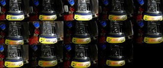

Here's my EJ-54D2 on the High Range, Fast/Narrow/NO autozero.
I do have scales that do have a couple few counts of non-linearity though.

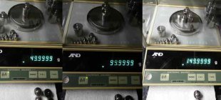

Performed the 50/100/150 linearity cal. Maybe better?

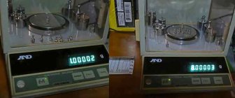

Checking linearity on the low range.
Resolution is better than my Class 1 standards (7 Rice Lake, 1 Christian Becker).
Gonna go to 10g with a 2 gram Class 1 and compare to my 10 gram (reported as 0.016mg heavy), then 10, 20, 30g.
Takes 20 to 30 seconds for each reading to stabilize though.
And a single kernel of Varget :)Varget.jpg
