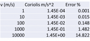

Centrifugal Acceleration is a maximum of the spin squared times the radius. So for the Earth spins at 1 rotation per day with an average radius of 6378 km which gives us a centrifugal acceleration of 0.034 m/s^2 or about 0.003 "g" of acceleration. That is so small that it is not really noticeable in ballistics.
Coriolis though is based upon the speed of the object. It is 2 times the spin times the velocity. For throwing a ball it is not noticeable and for most engineering applications we can ignore Coriolis as well but with rifle bullets we start to get significant errors. The faster the bullet, the greater the error.

So how do you correct for Coriolis? Well, it depends where you are on the Earth. The Earth spin vector points up from the North Pole. Part of it pushes the bullet to the right north of the Equator or to the left south of it. The other part of it either increases or decreases the apparent mass of bullet depending on if you are shooting east or west. This is the part that makes us launch rockets to the east as close to the equator as possible to reduce the apparent mass of the launch.
Given the uncertainty in calculating drop with drag, we often ignore the east/west apparent mass error but for long shots we need to include the small cross-range motion of the bullet. Most ballistic calculators include the cross range Coriolis correction. How do you know if yours does? If you need to enter in the Line of Fire (LOF) or direction that you are shooting and your latitude then your ballistic calculator can make the correction.
