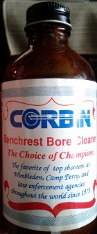

I sometimes use Corbin "Benchrest Bore Cleaner" on a tight patch wrapped around a Parker-Hale jag (not around a worn brass brush.)
