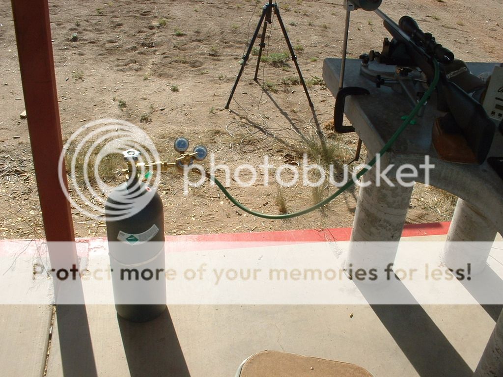

I live in S. Az and don't have the time to wait for a rifle barrel to cool on its own.
I have been using CO2 to keep a barrel close to ambient for load development. Been doing this for over a decade.
The idea is to use a slow flow from a 20 lb CO2 tank to bring the warm barrel to ambient. I only shoot two rounds from a magnum, cool, then wait for the barrel to stabilize to ambient. I use a infrared temp gun. I have found this is the fastest way to develop a load in our hot environment. The intent is to try and duplicate hunting conditions where the first round is from an ambient temp barrel.
I am not cooking the barrel like the fools with their ARs with 20 plus rounds in under a minute.
I am a hunter not a BR shooter. I have a borescope and monitor all barrels. I have not seen any undue wear of the throat on any rifle that has undergone this process.
