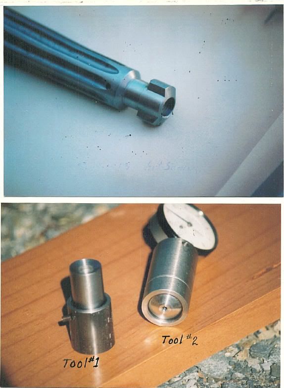

I agree with AL. Here is a tool I made to check the barrel tenon length to the action.. Art
