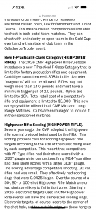

CMP did it new F class category
It looks like an AT tactical rifle may be able to be combined upwards into the new F-P category….. if there are not enough competitors (in a category).
If I am reading correctly, the Trigger and Barrel on the AR could be disqualifying……but I think I would let them shoot together in a club match.
A bit like our FPR - must have a magazine cut out, under 8mm, folding bi pod etc. Hasn;t really taken off - but growing. We dont have a $ limit.
The UK could do with something similar, if they haven't already. I probably know twenty or thirty people with that kind of equipment for every one with an F class rifle. It's a good way to introduce new people to the sport.
Our club used to have a F/Tactical class. It was less about restricting guns and more about putting the varmint/prs/factory guns together to compete on a same/same basis. I understand the need for rules, however I don't see this class being needed at a national level aside from providing guidance to clubs, but should be viewed as an easy access jumping off point for those thinking of F/O or F/TR, or a comfortable class for the casual competitor.
I'd really hate to see a class like this get "gamed" by higher level competitors looking for easy wins since it is designed to be entry level.
A small modification to the rifle can be made :)
Barrel. May have a maximum barrel length of 26 inches. Rifles may have a replacement barrel if the replacement barrel retains the original factory barrel contour. The cost of a replacement barrel is not included in calculating total retail costs of rifles and equipment. Barrel tuners, or items attached to the barrel that act as a tuner are not allowed.
So a suppressors is not a tuner? :)
Tom
So this class is only valid for high power prone matches? A 50 or 80 shot match wouldn’t count towards this class… am I tracking?
