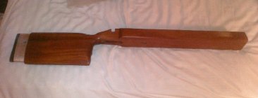

I just got a new wood stock, and I think I want to clear coat it. I assume this will make it slide in the bags real nice. What would the normal auto-body shop charge to do this? I do not want to do anything to the stock but drop it off with the areas I do not want coated taped off.

You might try a spray can approach using semi gloss or satin lacquer finish. Deft brand comes to mine and is available in spray and brush on styles. Your challenge will be to fill the pours to achieve a smooth finish so you’ll be sanding between coats. The wood looks like it’s already got a finish and perhaps even a stain on it so you’ll need to be careful not to sand through that. Paying a body shop by the hour to do this will be expensive. I doubt you’ll achieve a smooth finish by just shooting clear on the stock without some intermediate sanding. If you don’t want to try it yourself you might try a stock maker. Good luck with you project.

Just went to a body shop this morning. I asked the guy what it would cost. He said if I would tape up everything that was not to be shot (recoil pad, pillars, barrel channel) he would shoot it with 3 coats, then wet sand, then shoot it with 3 more coats for $125, and it would take about 3 days.
Is that reasonable? should it have more than 6 coats? Do I need to do anything to the wood before I send it to him? there are some "knicks and dings" in the wood. Do I get filler, and then satin it again? Do I leave it alone? Do I fill it, and then sand everything down smooth?

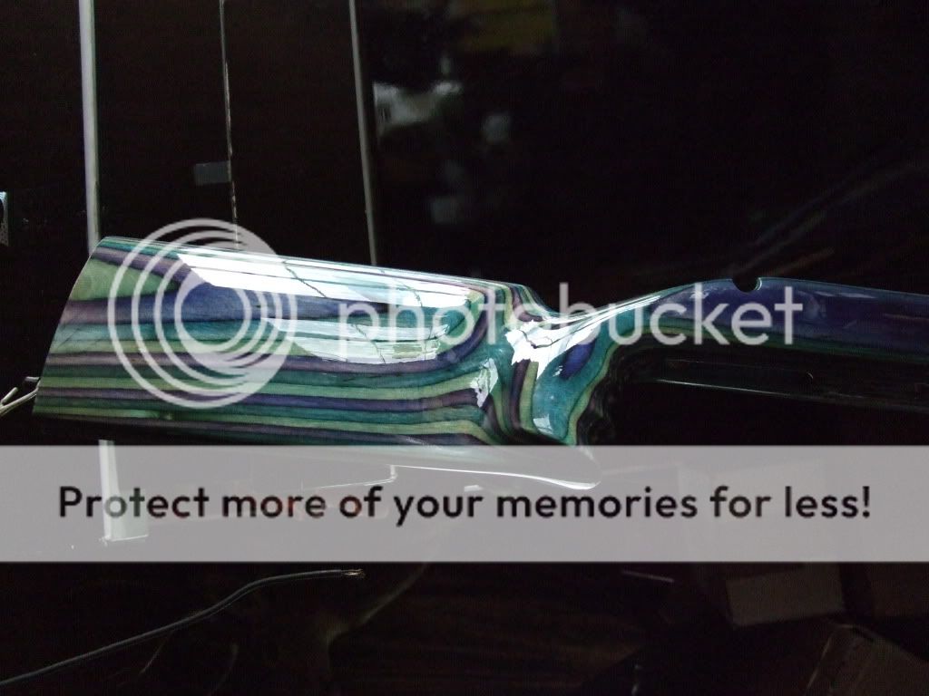

This ones about ready to buff out....

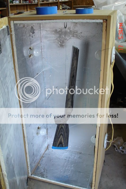

That sounds cheap. I sprayed 12 coats of auto lacquer on a Russo stock. The lacquer and reducer is very expensive. I built an oven to put it in after each coat.
It's a lot of work and the fumes are dangerous. Use a good mask. Up side was I did'nt have to drink as much beer at night after spraying.
