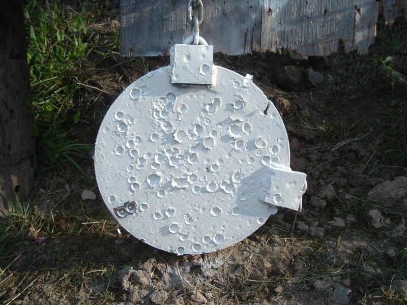

My RCBS sidewinder does double duty.
I use it to clean cases.
I use it to impact plate Danzak and HBN.
Have a dufferent drum for each.

You'll have to forgive the zero being off a tad.
Two rounds from a clean barrel fired from cases cleaned with SS media like described above.
Distance?
600 yards. :)
dave

Nice shooting on the steel plate Dave! :)
