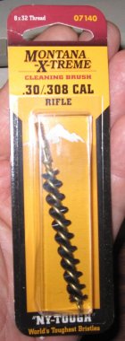

I would never Knock anything Tclaunch would have to say as he is a champion shooter and my friend but the only one I agree with is lpreddick, the necks should be brushed but not totally cleaned, no solvents of any kind is needed
Wayne, I believe Tim was referring to the Montana Extreme brand of Nylon brush...and not using the Montana Extreme solvent in conjunction with a Nylon brush for his necks.....But I could be wrong.... Maybe he can clarify. I myself use a Montana Extreme stiff Nylon brush chucked in a drill to brush em with.
Derek,
In that case I agree 100% with Tim and you, I use the same process except I use a rcbs case prep station with the Montana nylon brush, thanks for clearing the montana extreme thing up for me I was definitely thinking solvent :D
