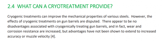

If you'll re-read my post, I never offered my opinion on cryo treating barrels. I'm just looking for you to clarify why something that may work for engines necessarily translates to rifle barrels. While you're at it, please quantify the improvements that warrant the extra cost.
YOU ASKED FOR IT.
Cryogenics Metals Treatment and why it just works!
All metal parts that wear (metal to metal) will benefit from Cryo. Barrels (any type metal), Receivers, Choke tubes, Trigger assemblies, Guide rails, Hammers, Extractor, Bolt carrier group, trunnion, Recoil springs & guidebolts. Cryogenics enhances your weapon in the following ways:
  • Relieves residual stresses
  • Promotes a more uniform micro-structure to the action and bore
  • Precipitates eta-carbides in steels for increased resistance to wear reducing throat wear
Cryo treated metals have the following benefits immediately:
  • Longer life due to reduced wear from throat/chamber erosion and corrosion
  • Less failures due to cracking that result from the propagation of stress lines
  • Reduced coefficient of friction on polished metalsImproved thermal properties
Cryo treating reduces throat wear due to high-pressure and temperature of high-performance calibers and high corrosive wear properties in chemicals found in cleaning agents for gun cleaning and maintenance. Stress relief in metals, reduces metal fatigue and distortions induced by design, forming, machining or environments.
Benefits of cryogenic treatment of your gun barrel:
Increased wear resistance for easier cleaning, reduce friction, heat, and reduced throat wear for an improved barrel life is what to expect from us. Improved shot groups resulting in improved accuracy and tuned barrels to the intended load and projectiles you intend to shoot.
Increased velocity of about 60 to 120+ feet per second are common and proven over a non-cryogenically treated barrel of the same caliber and twist. Our barrels really are that much better and there is a reason why.
NOTE: Every gun barrel produced today is bored and machined which causes stress in the microstructure of the metal. Guns are created from forgings and castings that cool at different rates, inducing residual stress. Your gun may shoot well, but it is not shooting to its potential without our proprietary double-slugging moly disulfide during cryo-treatment.
If you cryogenically treat your gun barrel, you will see several immediate results. When fired, a gun barrel heats up and distorts or warps every time you pull the trigger. This results in lost accuracy. Once a gun barrel is cryogenically treated, you will see improved shot groupings. This improvement will last the life of the gun as cryogenic treatment is a one-time permanent process and at $90 + shipping the best value you can put into your firearms... many times we find that simple adjstments with optics, optic mounting systems and Cryogenics is all that your rifle may need to shoot well as a sub-MOA performer. If this is the case, that is all you are into it is at best $90 to $500 for our basic tune and accurize and you have rifle that will be as good as you can be.
Several shotgun manufacturers, including Benelli have incorporated cryogenic treatment in their manufacturing processes. They found accuracy improved after cryogenic treatment by a wide margin over those barrels that did not have this process performed

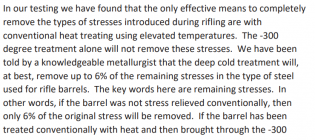

A few barrel makers cryo'ed in the past before seeing the light. Barrel blanks seem to machine a little better, but not worth the time and expense. So my "Beretta" has a cryo'ed barrel??
Sir, you may want to do a little research on cryo. What temp and cycle would be a true cryo on a barrel blank?
liquid nitrogen goes down too about minus 500 I can remember the exact hours but its like down for twelve and bring it back up then down again over about 48 hours.
I'm going to ignore your velocity claim, because I think it's BS. Who is "Our"? You're a barrel manufacturer?
Or, is this an artifact of copy & paste, without attribution? I only looked up part of what you "wrote", but this:
Was lifted from here:
https://www.nitrofreeze.com/services/conventional-cryogenic-treatment/firearms-gun-barrels/
Folks that cryo treat barrels really love it.
