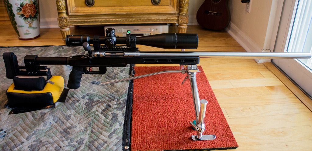

I like mine.
I got the piece for the front rest and made the rear bag piece.
It seems very stable
Haven't used this setup yet but I'm happy with it.
the element is well made all great machine work.

I have several chassis systems which I interchange for F-Class and F/TR plus I shoot them from a bench as well. I do modify the forearm with a flat plate for shooting with a rest and I made my own buttstock for bag riding for the Element.
The most comfortable chassis though for me is the APO Saber-Forrst Mod-1. It is superb but significantly more expensive than the Element. Then there is the Cadex Defense Lite Competition which is nearly as comfortable, just missing by a tiny bit.

currently used by one of four team members holding the US National Team Midrange (600 yds) F/TR record. actually this rifle had the highest scores of all the four team members including those who utilized high end laminate stocks.
XLR Element, .308.
don't dismiss the XLR. I have another one in use with a Bartlein 6BR barrel shooting in the .1's", .2's", and .3's" @ 100 yds.
both Savage Target Actions
I use an XLR Element for FT-R with the bag rider stock. Switched from HS PST025 and love it.
