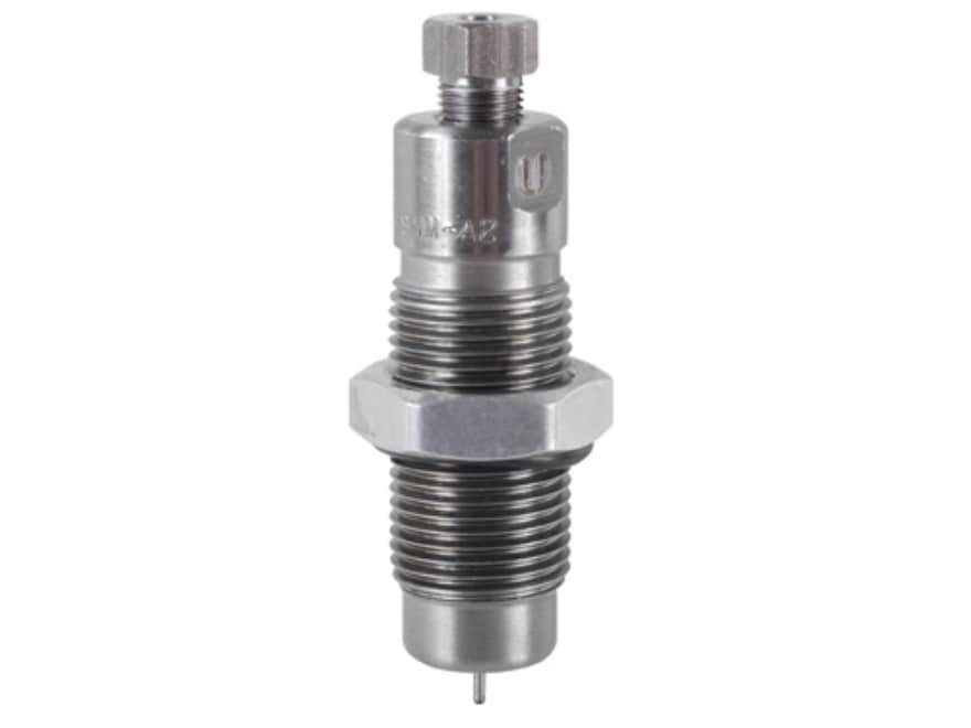

I just thought about something. A friend gave me some 10mm brass and some of the cases would not resize sufficiently, so I bought a LEE undersize sizing die.
