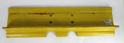

When I'm polishing a target barrel to a high polish, I can tell which areas have a higher polish while the lathe is still running. The smoother, more polished areas have a higher degree of friction with either the abrasive cloth or a Scotchbrite pad. I'm not sure why it matters one way or the other. Pull the trigger and the brass will fill the chamber.
Correct, the softer brass will FILL, / FIT to the chamber
so with micro scratches, the brass will ballon into the voids between the scratches
= more Gription
What grips a barrel in a barrel vise more, Polished aluminum or sandpaper wrapped around the barrel?
If you consider, that this dynamic is not the same thing as Tire Slicks having more friction
due to more contact area vs treaded tires.
Which is true in that dynamic. Simple surface contact
However if treaded tires bit into the pavement, then treaded tires would have more grip than slicks
Just like the reason a Bulldozer has cleats on the tracks instead of being perfectly smooth
