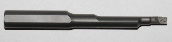

I can see single point cutting could work with larger calibres but I suspect tool rigidity might be an issue with smaller calibres. I guess very high speeds and ultra light cuts would be in order.
The GenSwiss SDQ bars work well, light cuts and screaming fast spindle speeds are needed. Doing them on a Swiss screw machine would be the hot ticket. But then you would have to have another machine to contour the OD.
I just dont see cnc cut chambers putting any reamer makers out of business. As many cnc machines as we have out there ive yet to see one cut a chamber on the equipment list

Back in 2007 already, Phil Bower set a IBS-1000 record in HV-Gun for Group with a CNC single point cut chamber.
In the industry, I believe all Tikka and Sako chambers are being single point cut as well.
Attaching a picture of a boring-bar used to single-point cut chambers. That particular one will do 243/6mm throats and/or larger.

Of all things, the difference between a single point cut chamber vs. one cut by a reamer will show essentially zero difference in accuracy.
The reasons for choosing one reamer manufacturer over another are customer service and a precise match of the finished reamer to the original order specs. All the reamers are made round and perfectly so. If you can dial in a barrel blank, you can cut a concentric chamber. If you have good working knowledge of your feeds and cutting fluids, you can cut concentric chambers with fabulous interior finishes.

I think his single point cutting tool thought was to give the smith the ability to adjust cut depths on a as needed basis. I can certainly see the theoretical advantage, but a TL1 is a pretty small machine relative to most CNC lathes. I can not imagine having to dedicate the footprint for a Mazac or something comparable for a typical size gunsmith operation. One thing that I have always appreciated in machining is there are many ways to do the same thing and it comes down to what works best for you. So more power to folks trying different approaches.
