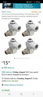

Here is the easy button on a rotary union:
