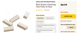

I have a chamber cleaning tool that I bought many years ago. I used up my supply of cotton or felt swabs and don't know where to get replacements or if they are even available.
I don't remember where I got it or who made it. I assume the swab is cotton, but it's very dense like felt.
The swab I have measures .950 X .250 X .375.
Any suggestions? I've looked at all of the suppliers that I can think of, but nothing similar is showing up.
Your tool looks similar to the Sinclair Cleaning Tool available from Brownells:
Brownells Link: https://www.brownells.com/tools-cleaning/gun-cleaning/gun-cleaning-kits/action-cleaning-tool-kit/
It appears that what you want are the "FELTS", but they are currently out of stock.

The Sinclair tool sure looks like it and Sinclair was a prominent supplier of precision shooting equipment when I purchased it 25 years ago. I think we have a winner.
Of course the pads are out of stock.

Both the round and square felt pads I got with my Sinclair cleaning kit are actually produced for dental care. I didn’t know that until we built an Oral Surgery Center a few years back. You can look on dental supply sites for them. You can get round cotton rolls on the Safco dental site, 2000 for $18. That’s a lot of cleaning :)

Sinclair still lists them, but they're out of stock. They also look slightly different.
