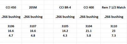

I have had a brick of 205M on the shelf for a backup in case 450s dried up. Decided yesterday to do a little side by side test. Fired nine rounds of CCI-450s, cooled ten minutes and fired nine rounds of the 205Ms. The Garmin gave me the results below.
PS: I am going to bum some 7 1/2 Rems from my son and see how they stack up.
4/6/25 I have been waiting two weeks to get the same range conditions as when I posted the above primer test. The weather was perfect today. 47 degrees and a slight cross wind. I shot all these rounds with about 7-8 minutes between strings. Three three shot groups. The results are amazingly close the the other two. The first two strings were fired on 3/23/25.
If you are asking me, yes I got slightly smaller nicer groups. Seemed with the 205's the load was easier to tune with N-133. Very little vertical or horizontal . This is in my Sako PPC. Now in my 6BR with N-135 and 64-68 gr bullets I found the 450 to be the prefered primer.
I have found the same with anything from 6mmBR on up I get better chrono #'s and better groups with the CCI-450 primer.
Wow, ...you actually got 210M's to fit in a small primer pocket? lol Just kidding, I think you meant 205M's. I haven't tried anything other than 205M's so far in 223 bolt applications so far.
Yes. I meant 205m. Actually they were the Fed AR Match.
