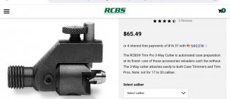

There seems to be plenty around:

Thank You , However not what I'm needing. I need the cutter designed for a drill press. Has to be carbide.
