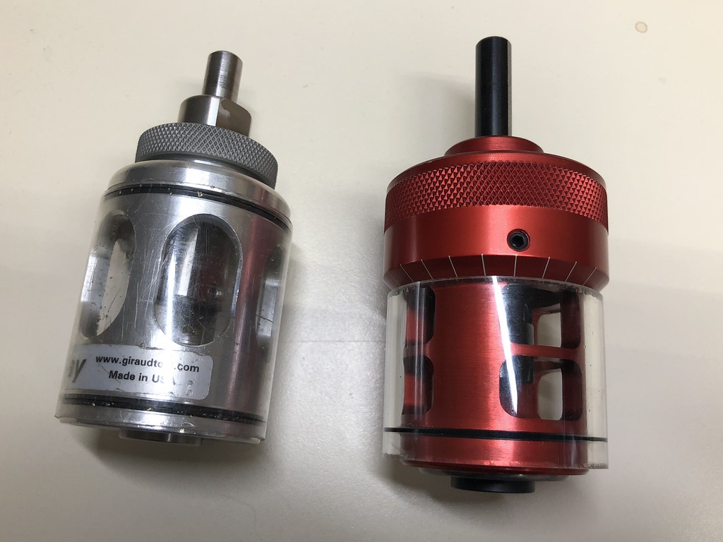

I have the Giraud and the Trim-it II. Both work on the same principal. The cutters appear to be identical to me. They both work well, are very accurate and fast. Trimming to length, chamfering and deburring all in one operation is very nice. The Trim-it has the advantage in my opinion because it's a bit easier to adjust and it is not caliber specific. The caliber dies are only $20. The newer ones have a lexan cover to capture the flying chips. Very nice product.
IMG_E3190
++3 on the trimit-II it works really well and is very east to control results - get the drive for it as well - that was an afterthought for me but sure beats rigging a drill up to drive it.
