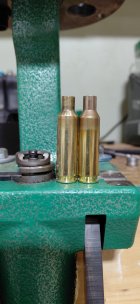

I got my barrel and fire formed 4 cases to send off for custom dies.
So far this is looking like a really solid wildcat, after the initial firing of 36 grains N150 with a 134 eldm jammed (MV 2700)
I loaded the cases 3 times after fire forming working up to 38 grains jumping them .035
Groups are around .7" without tweaking anything, and the 10 shots I chronoed were all between 2857-2870 with an SD of 4.
I measured Lapua case capacity, and prior to forming it was 47.5 grains, fully formed measured 49.2 which is slightly more than I'd expected!
