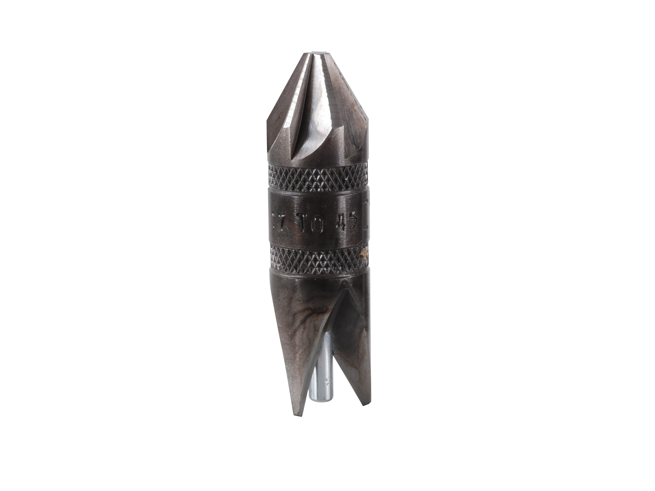

K&M primer pocket tools (uniformers, and flash hole), Forster trimmers (pretty much one per specific case as I bought them used), and VLD chamfer tools I bought from Midway. I have 3-4 older standard chamfer tools with holders I used for years but prefer the VLD style.

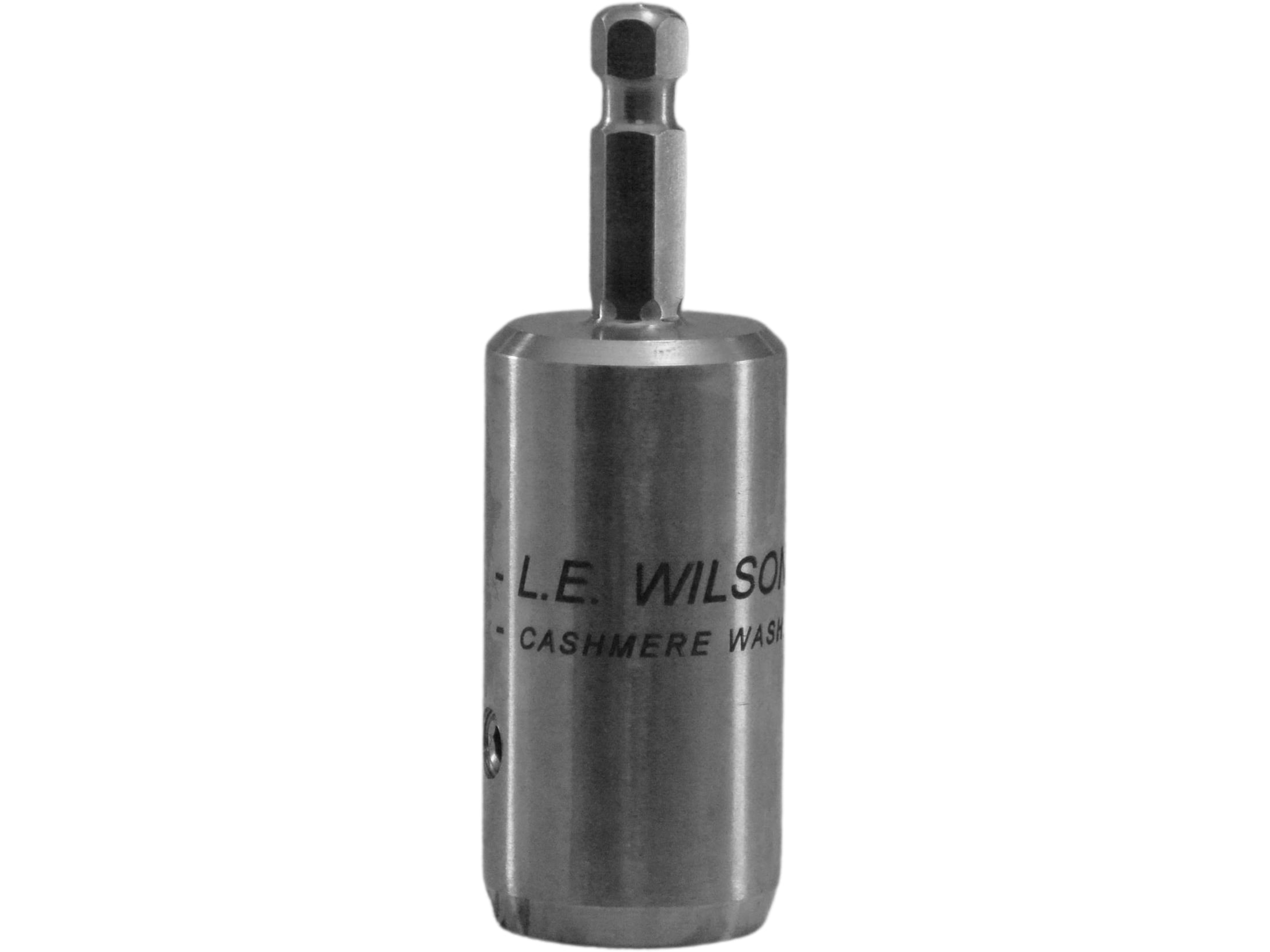

Deburr/chamfer and holder

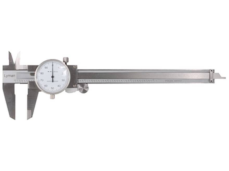

Lyman calipers

Chamfer and deburr - Wilson bullet

I use a RCBS power trimmer for my magnum pistol stuff. I have been pretty satisfied with the results. Just takes some doing to set up right. But I dont think they are worth what they want for them today. I use a Wilson for my rifle stuff. Dont know if anything could trim more accurately. I chamfer and deburr with a Wilson tool that fits in a electric screw driver. Its pretty quick. I use Kand M primer correction bits in the same electric screwdriver for primer pocket cleaning and correction,
