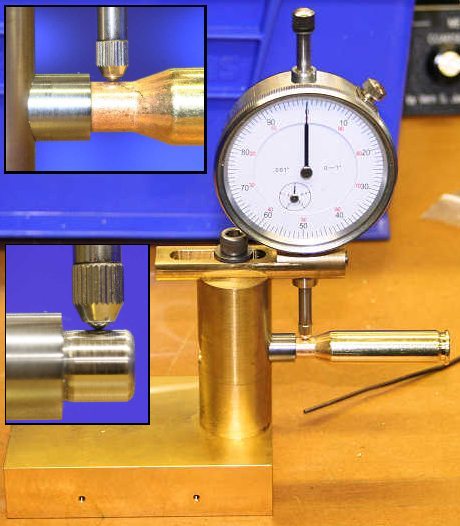

Mike Is your one something like this one built by Chris long and featured in a 6mmbr bulletin some time ago? except with a ball instead of a cylindrical guide for the case neck?
really keen to see some pics as I have a friend who is an engineer who may be able to help me build one. Alternatively could you build a ball anvil to fit the likes of the sinclair gauge?

The Chris Long style won't provide new brass readings as accurate as a tubing mic w/ball anvil.
It's difficult to describe why this is, but I'll try.
The issue is thickness variance from case forming, not just around the neck, but from mouths all the way to webs. And new brass already has donuts, with necks thinner at mouths than near neck shoulder junction, which is not always linear. This thickness change is for the most part -inside the necks, because cases were formed from the outside.
When you press an inside taper against a pin/post you're crediting the inside taper as linear and flush against a post for good measure. It could be, but less likely with new necks. There also has to be enough inside clearance for the neck to press flush against a pin/post under the indicator tip force. With turned necks, mandrel expanded, a pin/post could provide good readings.
A tubing mic with a pin would have similar issue, but with a little more force provided by the mic threading/clutch.
A tubing mic with a ball anvil, removes all potential issues.
In all cases you must have a mouth stop to set depth of reading, even if it means modifying a tubing mic.
To speed up readings an indicator could be used in place of a mic, but it would have to be a really good indicator capable of accuracy at .0001"(like a mic), and you still need a ball anvil inside necks as an indicator does not press with much force. You need point to point contact to pull this off.
Nobody offers anything like this with enough accuracy for our use. So it might be a bit pricey to build. But I think it would be very nice function-wise. Maybe a Sinclair neck mic(with the stand), and it's mic replaced with a really good indicator, and using bushings for a mouth stop.
