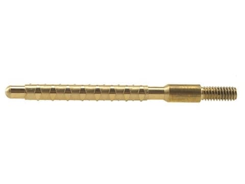

Wrap a strip of cloth on an old fashioned cleaning jag, so it barely fits the case mouth. Push the jag through so the case mouth is about the mid point of the jag, then pull on it and it will come out.
The old fashioned jags look like this
