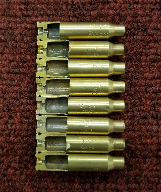

I have 5-6,000+ .223 cases from Rim Rock who was a commercial loader located near Nosler. I bought 55g Vmax Varmint ammunition from them for a few years. I'm guessing Rim Rock was sourcing their private stamped brass from Nosler and based by these cutaway comparisons, then measuring and weighing cases it was Norma/Lapua quality. Their ammunition was more accurate than Black Hills Red & Blue Box.
If you're curious about the brass you have it's quick and easy to take a few pieces to a belt sander or disk sander.
