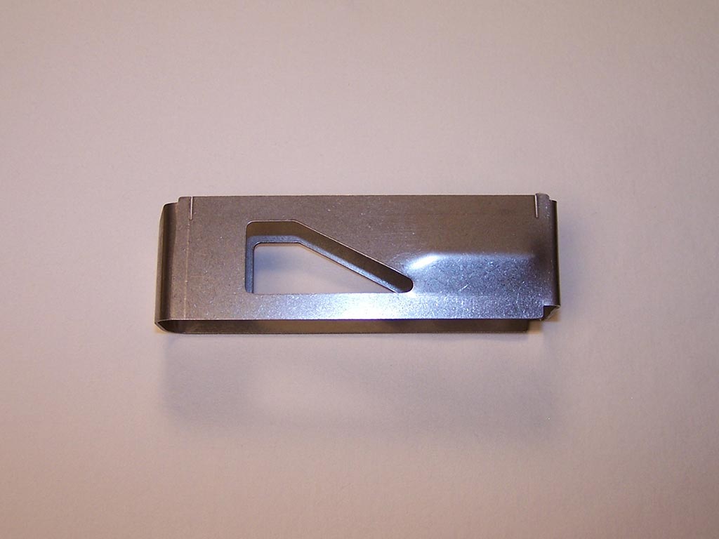

Pardon my stupidity, but is a "wyatts box" ?
No stupidity.
They mainstreamed extended length internal magazines in the 700. Let's you have a much longer overall length and you can use longer bullets and increase powder capacity. You just have to have enough throat or freebore to accommodate.
