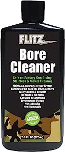

Been trying to get folks to try it for several years. Talked to the owner at length about it before I tried it. I tested a dozen or more cleaners over a 2 yr period and flitz was the ticket. Only had to use an abrasive in the throat or bore on 1 horrible bore. Flitz green liquid in the same stuff as the bore cleaner but cheaper with a different label. I asked the owner
Flitz is an abrasive, pretty sure..
