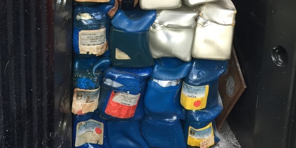

I have an acquaintance that lost his entire home. All the safes in the house failed to protect any of the belongings, a Cannon and a Liberty safe among them. As stated, if the fire is hot enough, the safe is going to get unbelievably hot inside as well. I like the idea of a sprinkler system myself.
I've seen a few guns that had been thru in a safe & hot fire. That combined with the water damage they were a rusted up mess. The heirlooms he wanted restored, the rest I'm not sure what happened to them..
