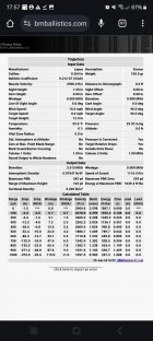

Here is your 100gr bullet and a 108gr scenar. What is the actual BC or your bullet so we can compare wind effects? And how come we dont see the 40% improvement in range you claim?

You're almost there. You added a tailwind to artificially increase the muzzle velocity. Fix that and rerun.

Awesome! I figured as much.
