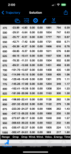

Just putting a lapua scenar 108 with Dr. Litz's bc, it is ending up at 1160 fps and 329 ft-lbs at 1000 yards, disproving that 40% improvement in range happyhellfire claimed in his other thread. Just proves that his claims are BS
I just compared his drop chart (shown below) to a 6.5CM using the 100g nosler ballistic tip (chart from Ballistic AE shown below) and they seem to compare at almost every distance from 500 yards through 1000 yards, with almost no appreciable difference at any of the distances.
Notice that we have the same velocity at 500 yards but by 1000 yards mine is 1086 ft/sec and the other is 989 ft/sec. The aerospike doesn't engage until it reaches the design point. My current design is to engage at Mach 1.6. Above about Mach 1.8 it flies like a normal bullet. When the aerospike engages at the correct Mach number it dramatically reduces the drag.
Also look at the lag time improvement. The TOF in a vacuum is about 1 second to 1000 yards. The lag time for the nosler is 0.8 sec. Mine is 0.72. That is a 10% reduction in lag time which is equal to a 10% reduction in cross wind error. I would think a competitive shooter would be interested in that.
I have more designs that engage at higher Mach numbers but I wanted to hit the market with a minor improvement that still looks and flies like a regular bullet with just a bit of improvement. If y'all find the bullet of equal accuracy to existing then the minor improvement will be worth it.
Here is your 100gr bullet and a 108gr scenar. What is the actual BC or your bullet so we can compare wind effects? And how come we dont see the 40% improvement in range you claim?
