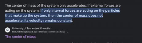

Do you at least agree that until the bullet leaves the barrel, the rifle is acting as a closed system? If so, do you agree the center of mass doesn’t accelerate until the bullet leaves the barrel?
Closed but not static.
If the center of mass of the system is accelerated by the internal force, you HAVE to understand that this means the bullet moves one direction and the rifle moves the other, due to the nature of the system and inherent motion of the components.

I know I’m driving in the lane less travelled, but, if the bullet came to a sudden stop at the end of the barrel, that’s the only change that would be evident in the closed system, recentering of mass.
The center of mass would not return to the same position relative to the barrel, because the center of mass for the resulting system would no longer be the same as the original state. Unless the bullet perfectly rebounds to its original position, the original center of mass position relative to the barrel will not be regained.
