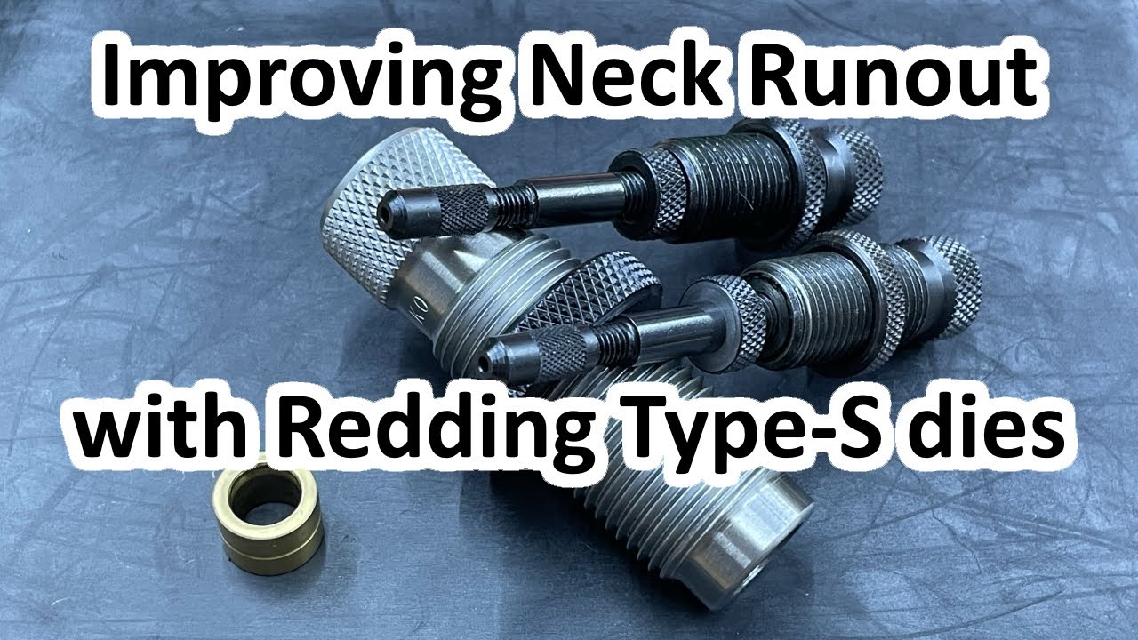

Have any of you guys done what this guy did?
I haven't but I'm not having a problem. Maybe others having a problem have tried whatever it is he does, I haven't watched the video.
I did try the o ring not the other but I have tested on target at 1000 yards at Deep Creek shooting range and as Alex pointed out bullet release was much more noticeable on target than runout. I was fanatical about having perfect rounds with little to no runout, I have since abandoned that part of my program. I do check now and again and I have very little usually.
