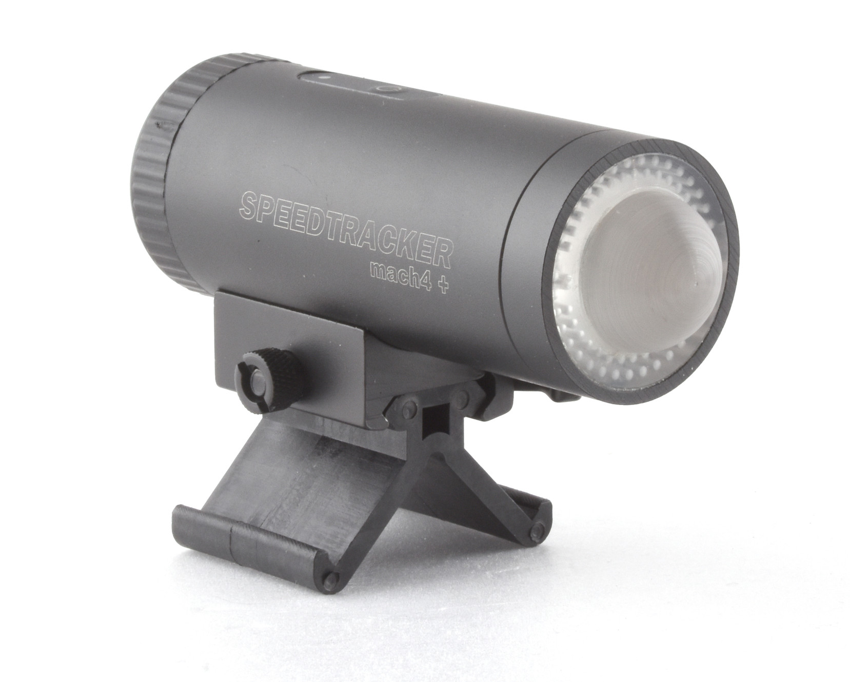

It’s continuously triggering so doesn’t need arming like the LR. I’m moving over because it’s not as particular in aiming like the LR and the beam is 20 degrees I believe and picks up for the first meter so shouldn’t conflict with any other shooters.
I’ve played with mine mounted just in front of the rifle and not mounted on the gun.

I only owned a Labradar for a month but as I remember you needed to disarm it between strings shots etc or it would drain the batteries pretty fast. That makes me wonder if the power efficiency of these new units is greater. Looking at the picture of the new unit there is not a whole lot of room in there for any decent size battery. I am looking forward to seeing some in-depth reviews and field tests in the next few months
