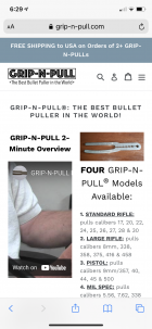

DGP4 in pulling those bullets what brand did you use?? i have destroyed several pullers and have never found one that would last.
I'm using the Lyman brand. So far, it works great and has lasted well over 5 years. The important thing is to use the right collet size and a very hard surface to strike. Again, if you keep your face away from the encased round I don't think you'd need to worry about the primer.
I am not worried about the primer. I was just hoping someone came out with a durable puller, the plastic ones do not seem to hold up for me.
