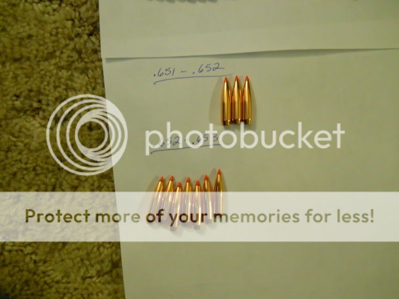

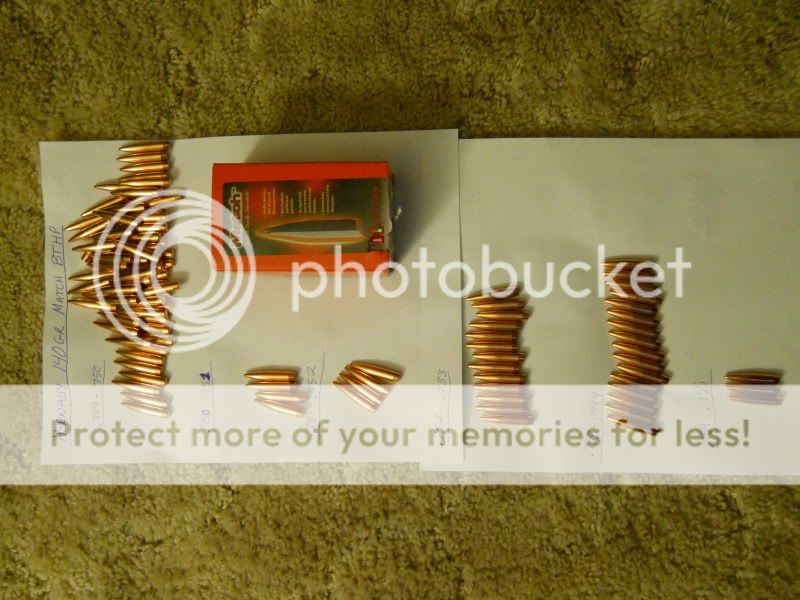

First up...Hornady's new 140gr HPBT Match Bullets

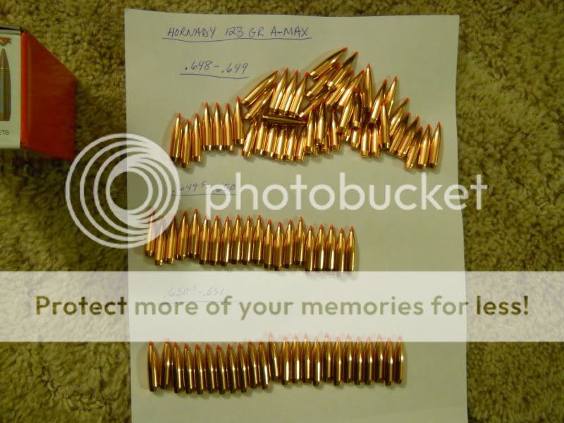

Next up...Hornady's new 123gr A-Max bullets. Better, but not good enough :(

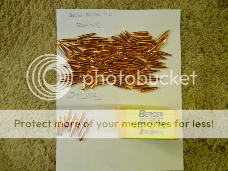

And Finally...Berger 130gr VLD Target bullets. All I gotta say is WOW! Even in the pile of .701"-.702" most bullets actually measured .7015". Only one bullet of the 8 in that pile actually hit .702" Simply Amazing!
Gonna have to stick with Berger if I want to get my money's worth : ) I could shoot them right out of the box. probably the most boring bullet I've ever measured cuz they're all the same! : )
When only allowing .003" tolerance in ogive consistency, I lost 32 Hornady 140gr HPBT bullets out of 100!!! That's ridiculous! Only 68% with a generous tolerance!
With the same tolerance for 123gr A-Max bullets, I had 10 bullets that were out of spec. Not too bad there,at 90%, but could be better with some extra QC.
Didn't even hit the .003" tolerance range with Berger VLD's. Every last one is suitable for top notch long range competition accuracy. The Berger VLD is "Truly" a Match Grade bullet.

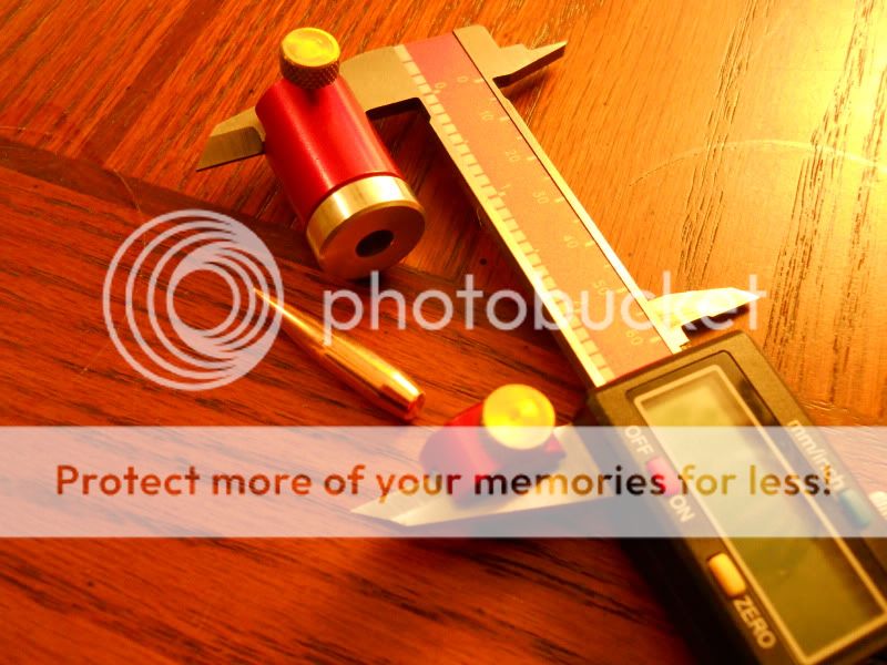

Here's some pics to clearly show how and what I used to measure the bullets. Ironically my measuring devices are all made by Hornady! Go figure : ) LOL!
This caliper is extremely consistent. You can see in the photos that I pull my battery when not in use. I put a battery back in to measure the 130gr VLD for this picture. I grabbed a random bullet from the box, re-zeroed my caliper, and you can see that the measurement came out to exactly what almost every single Berger bullet measured during my tests, .7005"

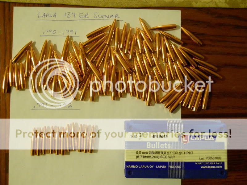

I just measured 100 Lapua 6.5mm 139gr Scenar bullets in the same manner. The results were very impressive indeed. The first sorting was measurements from .790" to .791". I did have 4 bullets that measured .7895", but none of the bullets in that sorting group actually hit .791". All were .7905" or .790". So there was still only a .001" variance in the majority grouping of bullets.
The other grouping was .791"-.792". There were only 11 bullets in that category and NONE of them actually hit .792". All were .791"-.7915". So actually only a .0005" variance there. Confused with my numbers yet??? LOL : )
Total variance was from .7895"-.7915". Only .002" total variance! Same as the Bergers. Shoot 'em out of the box cuz they're too boring to measure : )

Here's the pic.
