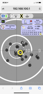

I had a long range 1000 Yard rile with an Obermeyer barrel that would shoot two separate groups at 1000 yards. I tried everything I could think of, but nothing helped until I started to move the seating depth back. I tested at 300 yards and started with my normal seating depth at .015" off of the lands and moved back in .015" increments at first the groups kept increasing in size until I got .125" off the lands and I had a 5 shot group measure .625" I thought that had to be a fluke, so I loaded 5 more at that depth and shot another group and it measured .500". The next day I shot a 1000-yard match and shot a 10-shot group 4.500" and it's been shooting 8" or under ever since.
