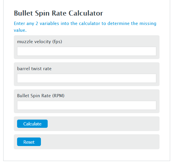

This is where all this becomes confusing and contradictive. I have an article published on loaddata.com dated Sep 13 2022, that gives his recorded load data with velocities from a 1:7 twist bbl using 5 different bullets and 9 different loads per bullet. I used a Bullet Spin Rate Calculator for fastest velocity of each bullet and found the rates between 332229 rpm for the 90 gr Berger and 371931 for the 69 gr RMR. Now he published group sizes for each load, so the bullets obviously made it to the target, and now I'm left scratching my head.

calculator.academy
Bullet Spin Rate Calculator - Calculator Academy
Bullet Spin Rate Calculator Basic Calculator Advanced Calculator Enter any 2 values to calculate the missing variable Muzzle Velocity (fps) Barrel Twist
calculator.academy
