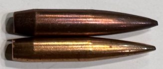

Here’s a good example. The top bullet is the DTAC 115 .243 and the bottom bullet is the 95 SMK .224. Both are Sierra-made. Tap on the picture and it will expand fully.
Clearly, the 95 grain bullet is longer, pointier, heavier “for caliber” - and nearly as long in absolute value.
Yet the bottom bullet has a lower BC, not because the form isn’t more aggressive, it definitely is, but because it’s giving up 20 grains of weight. It’s arguably harder to make longer and heavier for caliber bullets agg, as well, (BR certainly doesn’t seek out extreme shapes for group size) so, there is still no free lunch in the choice, and when the different shapes are considered, that the paths match each other if BC is the same makes good sense.
