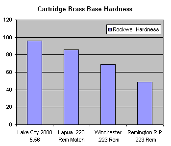

Military Lake City brass is harder than Lapua and commercial .223 brass. This is a requirement since the 1968 Congressional hearings on the M16 jamming problem.
How Hard is Your Brass? 5.56 and .223 Rem Base Hardness Tests
http://bulletin.accurateshooter.com...r-brass-5-56-and-223-rem-base-hardness-tests/
Below in the lower left corner is the hardness gradient chart, also the flash hole web is thicker and adds strength to the base and extends primer pocket life.
My observations are aligned with Uncle Ed's information. I have found LC brass, including the LC 18 headstamped brass, to be harder than my Lapua 223 brass.
When I seat primers in my Lapua brass, the rim is scored by the shell holder. Very annoying since after loading several times it makes it difficult to use shell holders that do not have some 'slop'. I do not see any scoring on LC brass.
