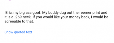

The late Stan Taylor ( God rest his soul) is the one who figured out the issue. And once the original barrel owner found his paper work m, we were able to confirm that the neck was in fact . 269. @markw who lives about 30 minutes from me was gracious enough to neck turn my brass, and bore scope the barrel for me as well.
