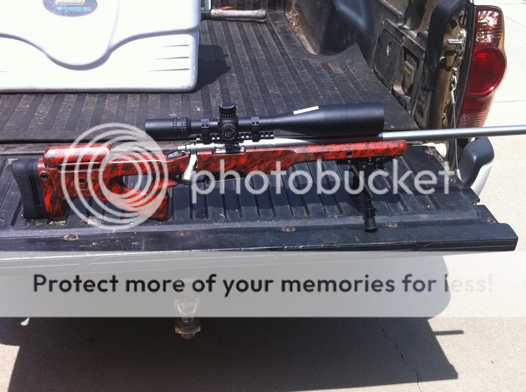

Here is one of the 6 BRs. It is Mike Ezell's fine work. He is "GunsandGunsmithing" on here.

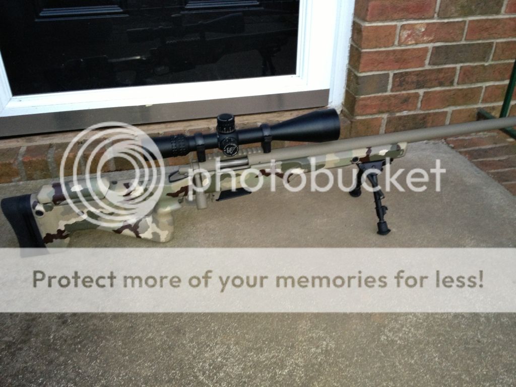

Captainzeke and I have similar tastes. Here is my .308
