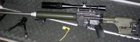

Just to help you out, this is what my F-TR .223 Match rifle looks like:
you just do not need a muzzle brake on a 223 that will be that heavy....way too little recoil in my opinion......
I had no illusions that it would actually serve it's purpose as a brake. Heck, my 14.5" barreled AR has next to no recoil. I was mainly going to attach one to protect the crown. But I'll be overly careful with this rig I'm sure.
