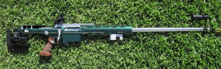

Jim Borden builds some of the finest actions made. I have two of his actions, one in an RTM chassis. Here's mine. [br]

Did he also do the barrel work/finish the rifle? If so, how would you rate the work?

Jim built the action and chambered two barrels, a .284 Win and .308 Win. I assembled the chassis. His work was outstanding. The rifle shoots extremely well in both calibers.
