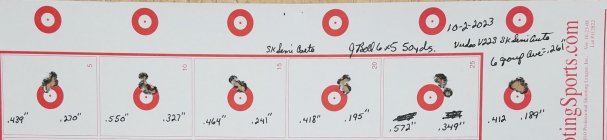

Well...you still haven't said anything I disagree with Sir.
I've found me to be responsible for FLIERS due to a bad read on conditions....when I'm shooting my better ammunition.
As for the groups I posted above....you wouldn't believe how many different points of aim I had due to wind changes while shooting each group.
