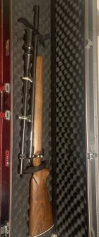

I have a Unertl 16x with fine cross hair and target dot with front and rear caps and external rings for sale 900 obo plus shipping
