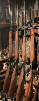

B78 on the right. Stock has cheek pad. Left of it the 1885s have plain stock
Three have English grips, When did they change the stock design to a pistol grip?
The one on the right is a B78. To the left is Winchester 1885. Far left is Browning BPCR
The partial seen rifle on the right is a Browning low wall in 22 Hornet
