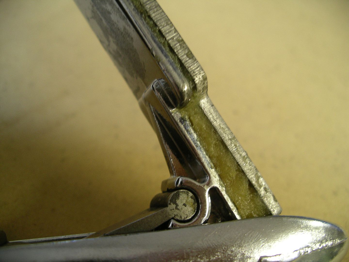

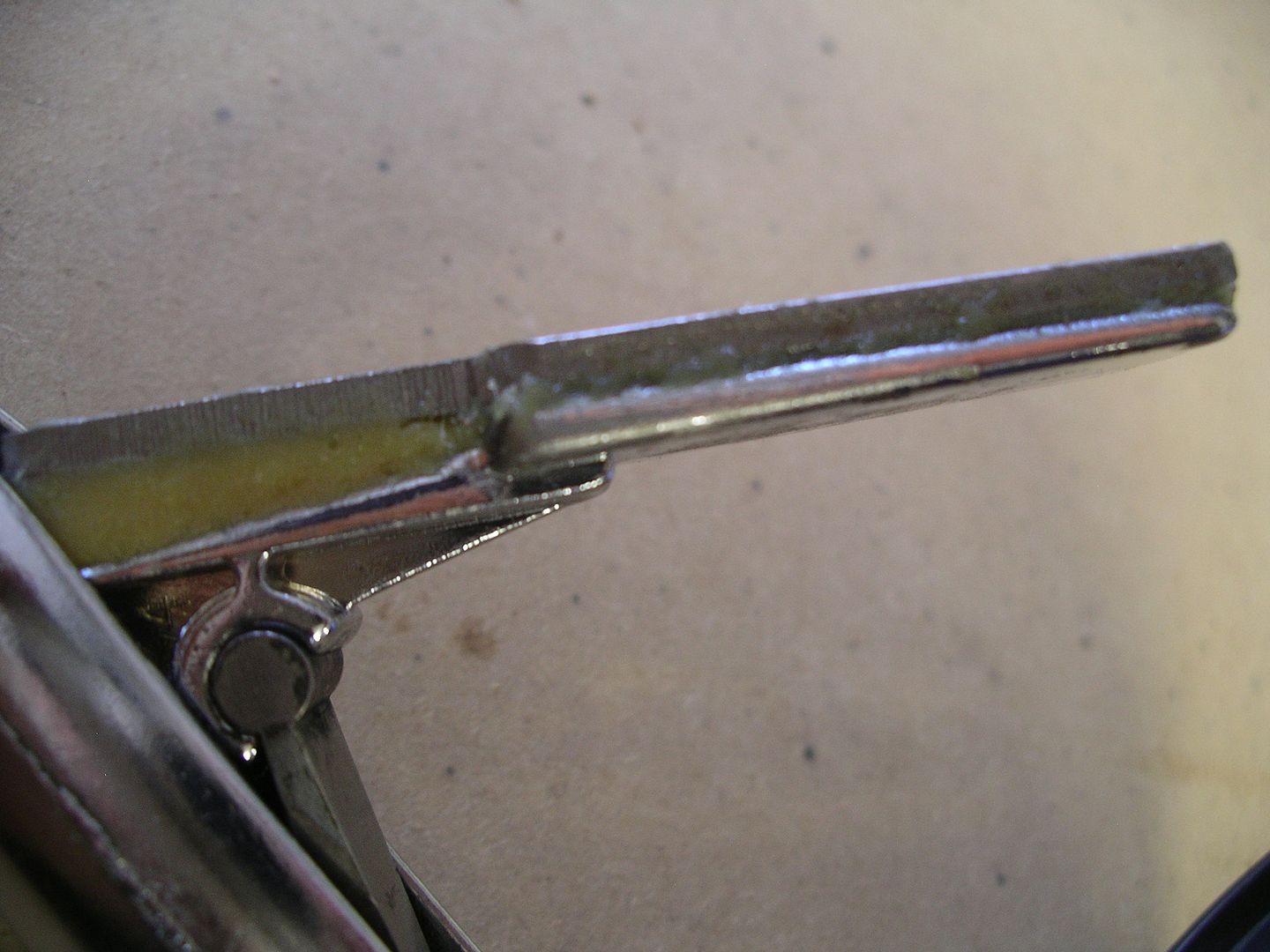

Your old round trays will fit on the newer auto prime hand held tool. The old broke handles can be fixed also with plastic epoxy with a small
steel rod set in it for a backbone . I think I used a 1/8 titanium rod on the two I have.
Use super glue on the joint before the epoxy.

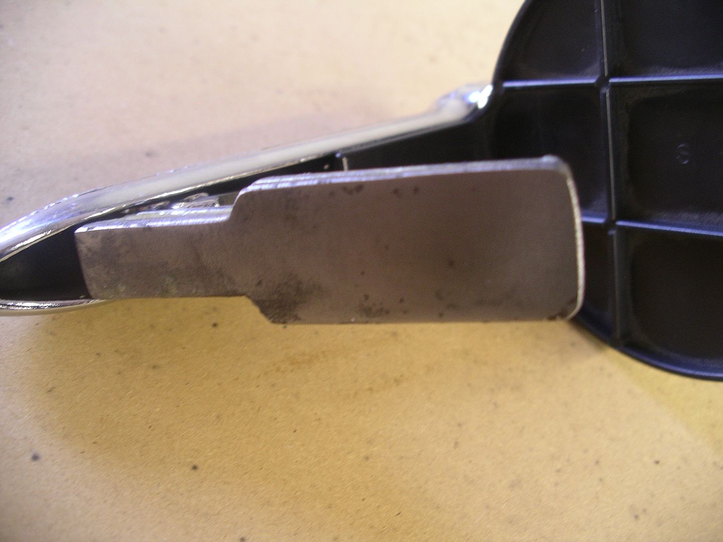

Easy to fix the broken handle on the old lee priming tools. 1/8" soft steel, cut out with a jig saw, then file. Use epoxy to sandwich the two pieces of metal together, and will never break again.
[/URL]
[/URL]
[/URL]
