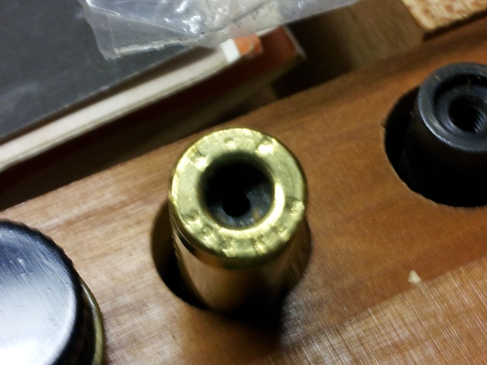

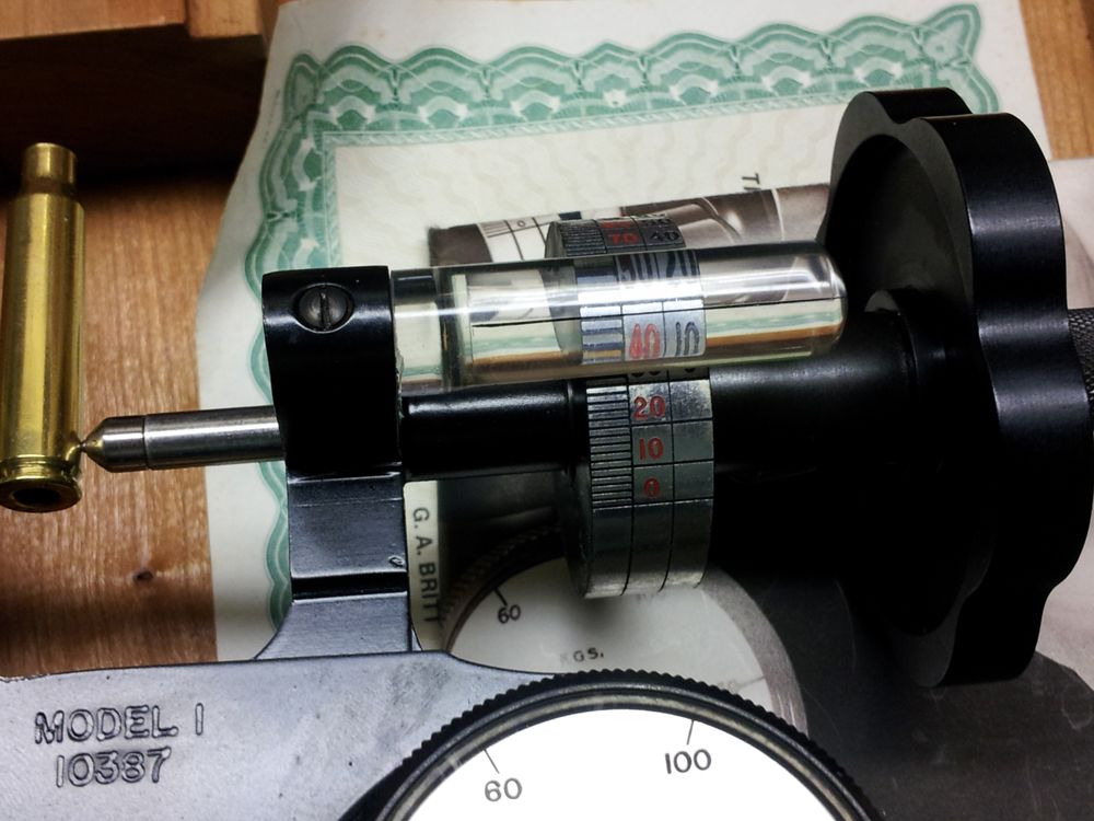

Most guys guess... but here are some real numbers I did in the spring of 2014.
Pardon the mess - it always looks like this in the spring and this spring is worse, cuz Martha Stewart's maid couldn't make it this month, and the woodchucks are calling...
My $2,500 Ames Hardness Gauge -- it is FAA certified and approved for testing aircraft engine parts (you cannot get a better tool than that!)
I measured four cases which were picked at random.
LC 2008 5.56mm
Lapua 223 Match
Winchester 223
Remington (R-P) 223
Lake City 2008
Lapua 223 Match
Winchester 223
Remington (R-P)
The actual Hardness measurements were (.062"x100kg, Rockwell "B")
LC 2008 = 96
Lapua 223 Match = 86
Norma 30-06 - 76 (added n Dec -'14)
Winchester 223 = 69
Norma .220 Swift = 64 (added in Dec '14)
Remington "R-P" = 49
For all you guys that have been saying that Winchester cases were tougher than Remington... you are vindicated, they are a lot tougher!... 40% tougher
For all you guys that think Lake City is surplus junk, nothing could be further from the truth. It is some of the most bestest brass made (it is paid for by the tax payer), so enjoy it!!!
LC and Lapua are the "The pick of the litter"!
(Ain't modern telephones wunnerful fer pictures ;) ??)
