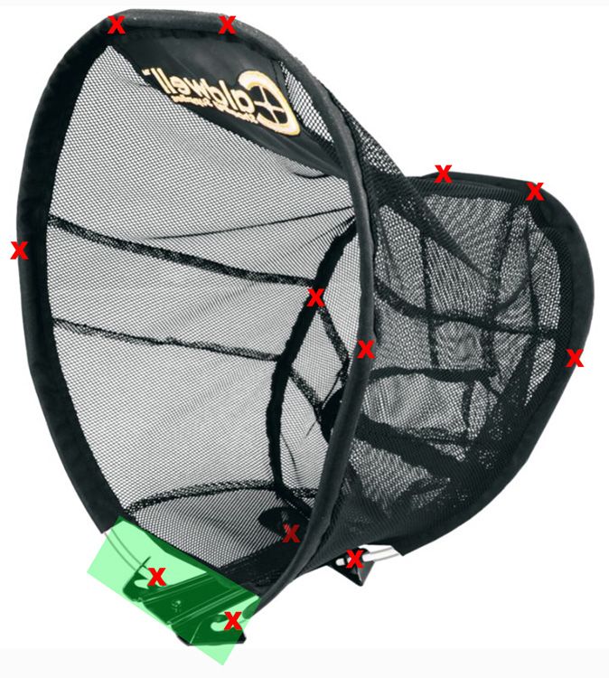

I agree that we are in the throwaway age and most people can't make anything. Dating myself, I came from an era where it was either make it, fix it, or do without. Yet again as I get older (a lot older) it's sometimes easier just to buy something it's reasonable and well made. And like everything you buy, you have to work on it to make it right. I like this catcher. It's porous and the wind won't blow it away. It was designed to be taken apart with slip joints where the red "X"'s are and stored in a handy dandy little storage bag. No thanks! I spent more time putting it together than using it. I drilled through where each "X" is with a 1/16" drill and ran a tiny piece of wire through. It won't come apart again! Also, it has a gap under the front and cases will sometimes roll under and to the ground. I made a flap (green rectangle) to cover this area. Another issue is the angle. To use with a pistol, I mount it to a tripod and angle it forward. If not, the brass ejects straight up and over it.
If you can sew this is pretty easy. I have sold a good number when people that see them in use.
