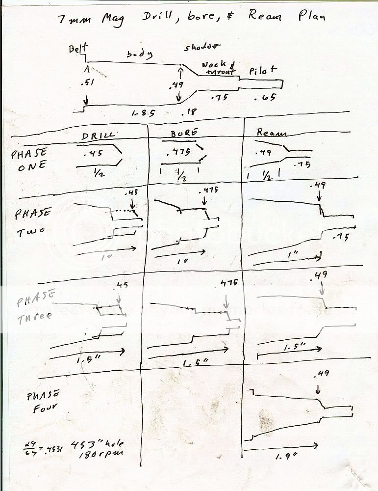

I draw up a plan for each chamber and reamer.
I have to decide the minimum pilot purchase into the bore.
Typically, I drill 1/2" deep.
Then I boring bar 1/2" deep.
Then I ream 1/2" deep.
Then I drill 1" deep.
Then I boring bar 1" deep
Then I ream 1" deep.
Ect
I hang that plan over the lathe.
Working backwards, I want the reamer to clean up .015" of the drill hole.
I want to chose a drill that is the next size below .015" below the reamer.
Often I will set the compound to the angle of the reamer.
The 1 degree marking of the compound on my lathe are not accurate enough for gentle angles.
I dial in the angle using something ground in the tool holder and cranking the compound handle.
DRO helps a lot.
I have to get all the chips out of the bore before I put the reamer in the bore.
I have to get all the chip off the reamer before I put the reamer in the bore.
To do this I first use a vacuum cleaner on the reamer and the bore. Then there are a series of brushes.
Finally, I have to get cutting oil all over the reamer.
My reamers do not get dull, but it takes me 3 or 4 hours to cut a 300WM chamber.
This is a plan for a 7mmRM, but you get the idea.
